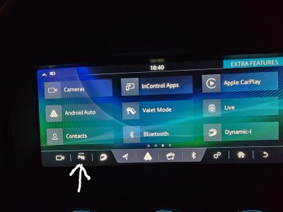

I have been having issues with my front parking sensors and have sent my car to my local Jaguar dealer for repair
When you were in drive and press the button marked with the arrow in picture do your front parking sensors activate? Im fairly certain they used to on mine. My jaguar dealer tells me that isnt the case and to activate the front parking sensors you need to put the car into reverse first and this button doesn't activate them. What happens in your car when you press it?

Mine do activate when I press that in drive, but I have to be going slowly (say 10mph?) or stationary.
Takes a few seconds to register, and other than the light showing up, the illustration of the car and the sensors doesn't show until I get close to something.
Thanks whoknows. Mine does nothing. Does a orange bar appear at the bottom of the button when you press it? Mine flashes orange then goes out.
Orange line above the icon you press I think.
