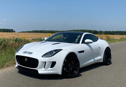

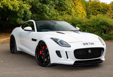

Had my stickered plate since 2017. Although only driven weekends never had issue with police & passed MOT’s through main dealer & Jaguar independents...
Sticker is on correct reflective backing with BS code etc.
Owners have come up with different solutions. I like the sticker as it clears the grill area & looks a bit maverick/different from the rest 👍

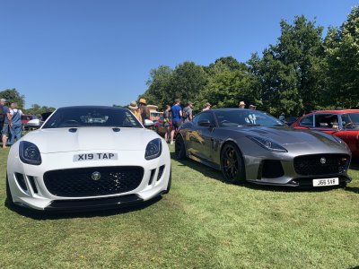

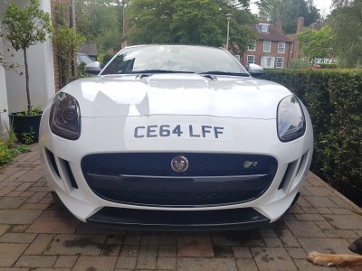

I checked with my MOT tester before changing, did this 4 yrs ago and never been stopped. I think it only really looks OK on a white car though. I got the correct material and size and spacing.

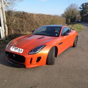

100% on anything but a white car (dont tell Darren i said that lol) those stick on plates look awful.
Why dont you try a sto & sho
Knew you were a fan Tim 😍 I’ve fixed your car & will save the £100 fine potentially coming your way 😂
