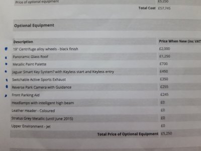

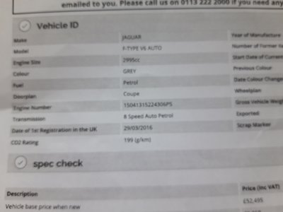

There is a hpi report that i got as part of the documentation that appears to mention a switchable exhaust as a £350 option?

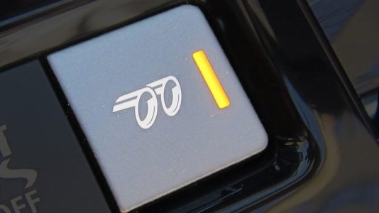

The £350 is the cost of the button as an optional extra. I checked the order form from my V6 where I added the button. Odd that it just says sports exhaust.
You can tell if you have an active exhaust as the valve stubs are visible just before the silencers (engine side). It became standard about a year before your car was registered, so it'd be very unusual not to have it.
Thanks for that Mick...
Strange that the list says 'switchable active sports exhaust' £350
But there doesnt appear to be any switch....
Maybe the list is wrong... its from a hpi check
Wonder what the original build spec says....
For reference, here's my F-Type without the switchable exhaust button.
That's not to say that the cars don't have active exhaust valves, I think it was an option on the 4-pots and base spec V6, but the S and the V8s had the active exhausts as standard. The button just lets you manually open up the exhausts, rather than the car doing so at ~4000rpm.
You can achieve the same result by pulling fuse 43 / fuse 15 as mentioned earlier in the thread.
