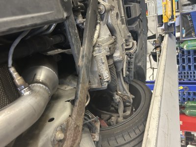

Had 2 new cats fitted a few weeks back at a place in Leeds Called Tony Banks Exhaust .
They used 400cel cores (600 is stock) and made me 2 new custom fit cats , they have been fine no more engine managenent lights on the only slight down side is it made the car a little louder. I ended up having a small renonater fitted mid way down the exhuast , now sounds stock again so very happy All in £800+vat
