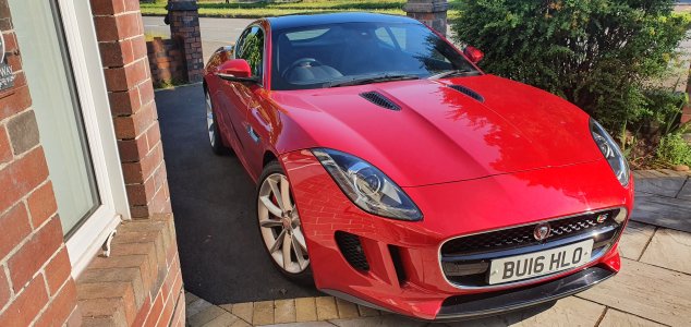

My first post on this forum as I am a super new Jag F-type owner.
After some searching and decisions, I have bought a 2016 plate 380bhp V6 S, which is still making me quite happy :) - even if I did let my missus drive it yesterday......
I watched a lot of youtube videos - and that was pretty much how I made my choice - the coupe, the V6 (S), in Italian Racing Red (or whatever it really is called - it's not the super bright red) - with panoramic roof - which really makes a difference. I bought it up North, but it actually came from Bristol / Cardiff, where it is again!

IRR is a great colour. I think the latest cars may call it Firenze red, but Italian Racing Red was the colour of your car on delivery.

Hi and welcome. Lovely looking car. Might be the picture but that looks more like Salsa red than Italian Racing Red. Enjoy.
Welcome. Looks great, enjoy.
I thought that too, it looks the same colour as mine.

Congrats! Looks like you got yourself a fantastic example there. In the picture it looks more like the bright (Caldera?) red than IRR but I guess it's the light.

Easy difference is IRR is metallic and Salsa isn't. Paint code near the door latch will be 1AF/CAH for IRR..
The only paint code I can find is 1AF - and it is metallic, so definitely IRR :)
Trim level is PDE - there's also a GH after that, but not sure if that is part of the code or not.
19" rims Aquila type.

You either have a bad camera or that def isnt irr, ive never seen irr look like that.
Also didnt the S come with 20" wheels and different hood vents!!!
The colour does look different to the IRR shown in these links....
https://www.ftypeforums.co.uk/viewtopic.php?f=18&t=6020
https://www.ftypeforums.co.uk/viewtopic.php?f=18&t=5615
However, the OP has stated the paint code is 1AF (shown on the UK near side ‘B’ pillar label) which is indeed IRR. Perhaps it’s the way the light is catching it or picture quality etc? Unless it’s had a respray?
The V6S came with 19 inch wheels as standard and also the open mesh bonnet vents on MY16 (as per the OP’s pic).
Here's another photo of IRR. This is the same car as the one in the second link provided by RSPN, using the same camera (Pixel phone).
IRR changes significantly in different light conditions.
