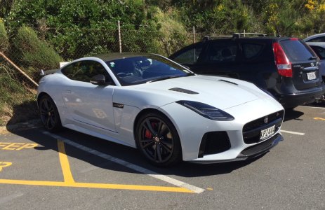

Had my SVR with 3000km's on it in the shop last week. Metallic scraping noise while turning left and the driver's seat right side bolster has come loose at the back.
The mechanic said a bolt holding one of the brake shields had loosened and was gouging the disc causing the scraping noise and the seat leather at the back of the bolster is just a press fit into a channel in the frame and it'll probably happen again.
I'm pretty sure I felt the leather pop out a couple of weeks ago during hard acceleration up a (very) steep hill so I guess the new lightweight seats might flex a bit under load.
Hopefully it's just a few teething problems as I kind of like this car (after never feeling quite at home in a V6-S)
