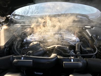

Is there anyone out there with an F Type that’s had a catastrophic cloud of steam failure of the Y coolant pipe?
I too have heard the rumours but never met anyone who’s had this problem,.
“A well known weak point” how much of a problem is it.
Back in 2002 it was a weak point on my S/C 4.2 V8, I took that engine to well past 100,000 miles no issue.
That’s 10 years before the first F Type to get the redesign right !
At that time, the “Nickasil and faulty timing chain tensioners” era had passed, what was there to worry about .
IMS bearing? Nope we don’t have those, that’s the Stuttgart lot!!
I’ve seen it mentioned over on the US forum and there’s been plenty of discussion on here regarding the differential failure. Have I missed the post on the “Y” pipe failure.
Apart from the “ there’s another redesign”. And I’ve heard.
I’ve also had the conversation with Tom Lenthall, yes he has seen a few fail but a catastrophic end of life failure would be a pretty poorly looked after Car driven by someone who doesn’t care.
He told me to keep an eye on the coolant level and if it drops get it booked in and you’ll be OK.
Most likely, It’ll be the expansion tank or something else simple but didn’t recommend pulling the top off just to do the coolant pipe
I know that @Timbo had his changed a couple of years ago as a precaution because the Supercharger was off, it made economic sense to change it.
I recall @Tel posting he’d acquired an Aluminium one as a replacement.
Anyone with a major failure ? eye’s got t’ know.
