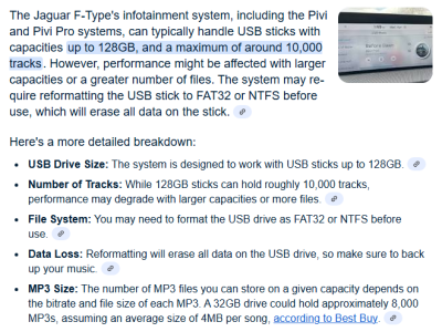

Here’s some information which may help? https://www.ftypeforums.co.uk/viewtopic.php?p=85390#p85390
Cluck said:
I also use a USB stick in the centre console area, loaded with thousands of my ripped CDs. It has glitched once (about 15 months ago) in the 4 years I've had the car, but I just wiped the USB stick and copied the music back in and it has been fine again since. The large centre touchscreen shows the USB stick as a new audio source when it is plugged in and away you go.
I'd be surprised if the media system can't read exFAT drives, so if you reformat the drive I'd suggest trying that. It can handle larger file systems than FAT32.
NTFS on a USB stick can have problems I've found.
