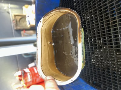

Below is the pick of how bad my diff oil was at 47k miles, believe Jaguar may have missed the diff oil when they were supposed to do it because car had only done 7k at that time.
