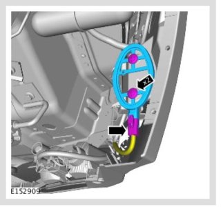

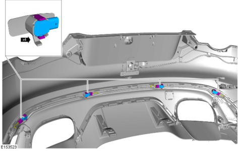

Could be one of your reversing sensors:
Depending on the type of connector (photo would be needed), it could be a light connector also:

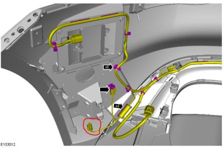

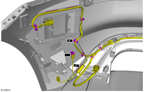

Thanks for this, just seen the post it’s not a parking sensor or the reverse light, although the reverse light connector at the bottom of the bumper was loose so i cabled tied that firm, it looks like the one in the bottom pic with the 6 purple clips on it? My photobucket account is full so I can’t upload any pics until I delete some, I’ll get on this.
What’s the connector in the bottom pic top left of the photo ?
The one highlighted in red is the initiators for the Tire Pressure Monitoring System.
The rear initiators are located at the rear of the rear wheel arches, behind the fender splash shields. Each initiator has a
connector which connects to the vehicle body harness.

Yep it’s O/S drivers side as original post, it’s the sensor directly above the one you’ve highlighted in red, top left of pic. Thanks
if you have it as an option the long cable is for the Right Blindspot Monitoring Control Module (BMCM).

I took the car in today to the local dealer and it was indeed confirmed it’s a redundant cable which appears to confirm the option so it was re-fixed to the loom so alls good, thanks again for your help guys, very much appreciated, it’s great having a brill knowledge base forum.
