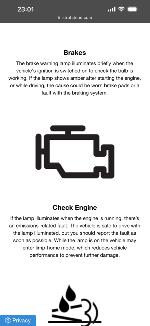

My F-Type on Sunday came up with this engine warning light (see attached engine symbol and text), I checked the Jaguar website and they say its a emissions fault and say I can drive the car, but it may reduce performance, this is an understatement, the car actually sounds and feels like a diesel tractor and I am concerned that if I do drive this whilst this is illuminated I may cause damage to the car/engine (even though Jaguar say you can drive it)

I'm confused which warning light you have on but presume it is just the emissions light in orange which could be anything but more probably an O2 sensor however that wouldn't cause bad running. Don't really understand your post about the car being 5 years old when you don't even know what the problem is yet.

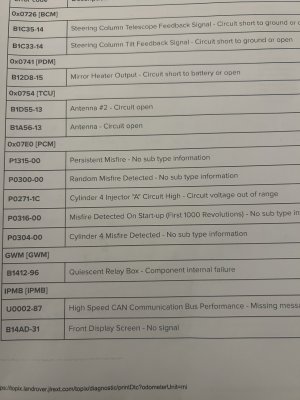

I did get Jag on Tuesday to run diagnostics (but it was at the same garage who were just as confused as me on the initial seat belt error OK to continue warning, which I know now I must have been brain dead and not thinking), that same garage said the (I have the DTC Summary) issue is a Cylinder misfire, the car really isn't driveable when I did drive it I could hear the engine ticking and sounded like it was going to cut out
Here is a picture of the DTC summary

I would guess a failed injector then. Again not uncommon from the few issues reported with cars.

Got the RAC out on that engine warning light finally, they run diagnostics and said its Cylinder 4 misfiring - they have quoted me £526 to fix it
Hi, my car finally after 8 weeks went to Jag yesterday to look at this Engine fault light, they have confirmed today that is a cylinder misfire and needs to be replaced, however to do such a job they need 22 hours just to lift the engine out and they have quoted me around £5K for that and then another £5K in labour just to do the job (didn't quote me on parts yet)

Sorry what are they replacing? And why do they need to take the engine out? Surely just an injector which doesn't need the engine out and 22 hours of labour lol
