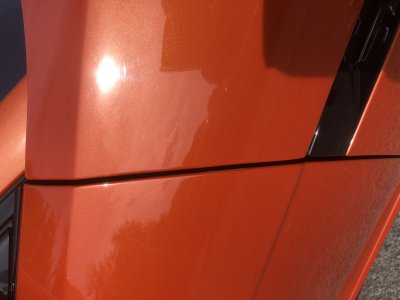

Can anyone please help with how to increase the gap in between the front of the door and bonnet?
When the sun is shinning on a warm day the door and or bonnet expands slightly reducing the gap and on opening the drivers side door it catches the edge of the bonnet quite badly.
The bonnet just needs moving forward a mm or two but I cannot see the best way to adjust the bonnet forwards slightly, can anyone please advise?

Can you edit your photo to show exactly where the driver’s side door catches the edge of the bonnet?

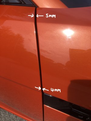

The gap between the door panels and bonnet on my car is approx 5mm at the top and tapers down to approx 4mm where it meets the fender panel (I’ve edited the photo you provided to include these details) and the doors open without catching against the rear of the bonnet.
If you do need to move the bonnet slightly forward, first of all check to make sure you have sufficient clearance between the bonnet and front bumper panel (front and sides). This alignment can be very tricky as you may find that once you stop the door catching the bonnet, something else will be out of alignment.

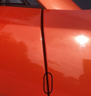

Thanks RPSN, the gap where the door catches the bonnet (highlighted in new photo) is only 3.5mm measured whilst over cast and currently not catching, I had read the attached file but along with previous comments now all confirms how the bonnet/door gap is adjusted, the problem first occurred before I had made any other adjustments to the black bonnet stops.

That’s only a 0.5 - 0.75mm (approx) smaller gap than mine in that area but it's enough for your driver's door to sometimes catch the rear of the bonnet. As it's only happening on one side of the car, it may be that the bonnet adjustment is not needed and the issue could be caused by the alignment of the door itself, which can also be adjusted at its hinges?
It's worth checking to see if there are any signs that the driver's door hinges have been moved/adjusted from their original position. Also check around the exterior door panel to ensure the fitment looks ok against the surrounding bodywork e.g. no large or uneven gaps etc.
If the bonnet needs adjustment, have an assistant to help, but if satisfactory alignment cannot be achieved it's probably better to leave it to a good body shop as previously mentioned?

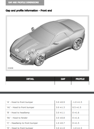

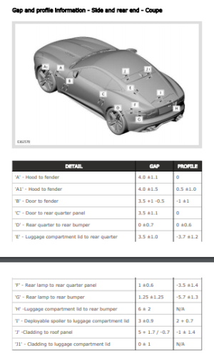

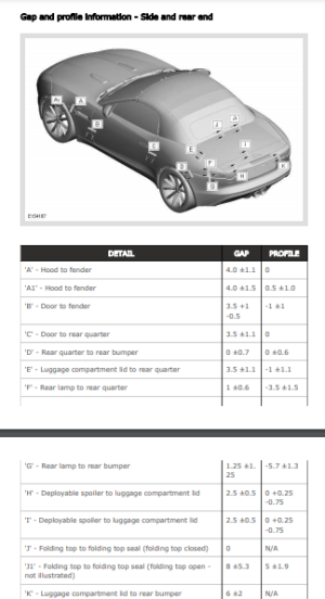

I've attached screenshots of the F-Type 'Gap and profile information' (convertible and coupe) for the front, side and rear end.
Hope this helps
