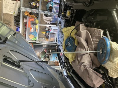

Cleaned up the dowel pins, and could take off next time easily.
The long wood lever did not work, but 2 x 5Kg weights on 2 x 500mm M8 threaded rod worked a treat.
