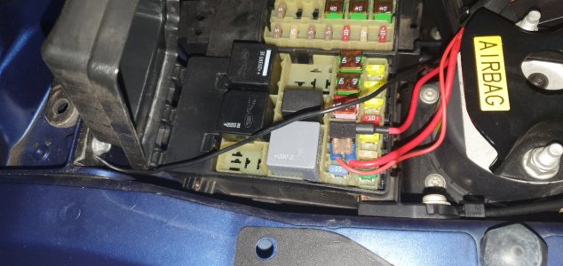

My setup (black wire goes to earth on car):
And in the car, there is an earth near the fuse box, my set up is currently just tucked in a gap but aim to fix it better. Fuse box does close but won't want to open it too often as it might damage the wires:
