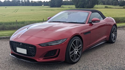

I'll be able to do that later this afternoon for you. I have a 5 digit plate on my 2021 car. Looked into a few options, but in the end I cut the original plinth.
scz4 said:
I found some pictures on my phone. Let me know if you want close-ups.
Exactly what I was looking for - thanks very much, it looks good.
Out of interest do you remember whether you cut the ends off the plinth to shorten it, or took a slice from the centre then reattached the remaining halves? Can't quite make it out from the photos, so a tidy job either way! Cheers

I just placed the plate on, marked ends masking tape then used a hacksaw and cut 1cm in from the tape (you have to remember the top of the plate has curves)
Best method for sure would be to cut in the middle, but I don't know anyone who can "weld" plastic.
So for me it's a 9 out of 10 looks for 1 out of 10 effort and 10 out of 10 for plate security.

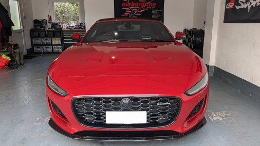

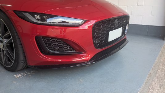

These grille clips are a great way of fitting a plate to the honeycomb grille if you want a really clean look and remove the plinth completely:
https://www.bespoke-plates.co.uk/shop/accessories/honeycomb-grille-clips/

To remove the plinth completely, undo the screws holding the plinth to the brackets underneath. The brackets are held on with bolts from behind and wing retainers which need to be turned horizontal before they can be negotiated through the hex grille holes. The best way to achieve that without taking the whole front off the car is to use a Dremmel with a metal cutting disc and cut a groove into the exposed tip of the bolt and then use a screwdriver in that groove to back the bolt out from the front. Don’t back it out too far though, you don’t want bits dropping out of reach behind the grille! Once those are loosened enough, get your fingers or some other tool in through the adjacent hex holes to turn the wing retainer horizontal and then negotiate it out through the hole.
18ME said:
I find my number plate slightly loose with the current clips going in to the grill and it slightly dips down, as you can see in the photo. With an 8 day trip around Europe taking in some of the famous passes coming up this year I don’t want to lose the plate so might look at trying to get some slightly larger clips.
@DOC 1W does your plate stay on firmly or is it easy to put on and take off?
The clips I have used hold really firmly, not loose at all, no risk of the plate dropping off. The plate is removable though fairly easily, you have to get your fingers in behind to squeeze the plastic of the clips a bit and pull.
These definitely work well. These are what I have used. They hold the short front plate really firmly into the hex grille holes and it looks really neat without the plinth. They also allow the plate to be removed completely relatively easily with a bit of fiddly persuasion if you want if you’re at a car show or something.
