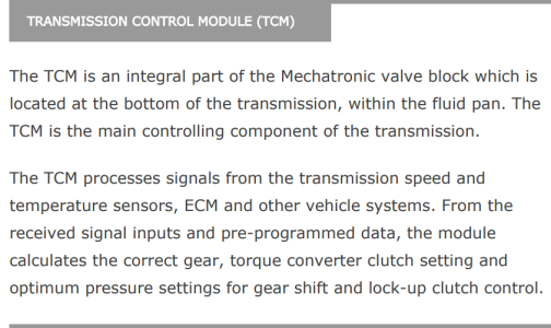

Worth checking for any transmission oil leaks at the same time. If the oil change doesn’t sort it something else to consider is the Transmission Control Module (TCM).
Here's a screenshot from TOPIx....
