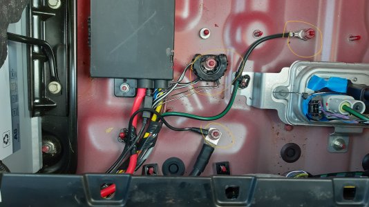

You've probably already checked these, but just in case: There are 3 earth points on the boot floor, circled in yellow on attached photo. Ensure they are making a good connection, especially the bottom one with the main heavy cable. This cable might not move when you wiggle it, making you think it is tight when it actually is not. Again, probably obvious, but recheck that the connections to the battery itself are tight, not just sitting over the terminals.
+1 for that.
Further details on it here https://www.ftypeforums.co.uk/viewtopic.php?p=60018#p60018
Thanks for all of your help friends, it actually ended up being this - the earth was attached to a different point in the boot and I can tell the original point has been sheared off. Now attached to a different earthing point and working well!
You’re all better than most of the mechanics I spoke to and the AA :D
