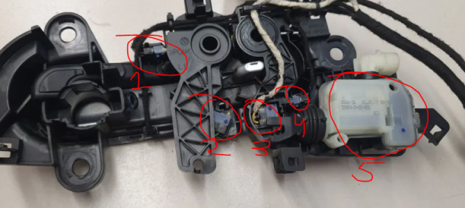

Tell me, which button is responsible for arming when you press the knob 1, 2, 3, 4 or 5?
How to find out the marking of the button 1,2,3,4 in order to buy the same (or analogue) and replace it? Or do you need to disassemble and repair 5?
As I understand it, 1,2,3,4 there is a company microswitch 2-pin "BURGESS", but how to find out its exact model (article)?
Not sure about the others but the item you have circled as number 5 in your pic is the Actuator (Jaguar part number T2R7801).

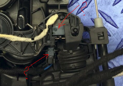

I mean, my problem is that the car does not close when you press the handle (keyless entry), who knows, does the microswitches 1,2,3,4 not work or is it part number 5?
There are suspicions that one of the microswitches 1,2,3,4 broke (which I highlighted in red in the picture), so, I want to buy these microswitches, and then disassemble the door and change them on the handle, so I would like to know their marking so that order correctly, who can tell?

Yes, I was aware of your problem which is why I gave you the link to the door handle component diagrams and part numbers.
In the link, the microswitches you mention seem to come with the door handle (the wiring is there) and the actuator is bought separately (see screenshot). I’m unsure if you could source the microswitches separately somewhere else?

The question is that just one of the microswitches does not work, I want to fix the handle by replacing one of the microswitches, without buying a whole handle because of one microswitch. It may not be possible to find the original microswitch, but it may be possible to pick up some analogue

This is not a battery, because on the passenger side, pressing the handle (keyless entry) works well, but on the driver's side it does not work, the workshop diagnosed the problem, the microswitch in the handle does not work, the entire handle is replaced, but the question is, what can be fixed handle, because the problem is just a non-working microswitch, which is not difficult to replace, the main thing is to know which one, so that before removing the handle, order it, or its analogue, and then replace it

I believe I understand your ask, but this is unlikely to be anything that members on here can advise on from F Type knowledge, but perhaps if you're lucky and they have other electrical/electronics skills. These microswitches won't have any individual part numbers, but will be assembled by a third-party supplier using generic parts. If you are competent on changing such microswitches in a manufactured unit you should have the ability to test them and source a suitable replacement. That's what I have had to do in the past on components such as a remote key when I wanted to avoid buying a new key and paying for coding
