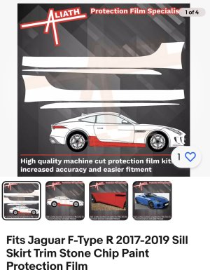

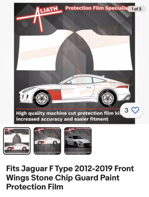

Cannot help with suggestions for detailer but I’ve just applied PPF myself to some newly painted & polished panels.
You can purchase pre-cut sections. Just need spray bottle with tiny bit of soap solution, squeegee, hairdryer & a small craft knife. All nicely protected & saved a few quid for a change!
The pre-cut sections come oversized to wrap into the edges of panels. I used the craft knife to cut them approx 5mm short of edges. For me a better finish & less likely to lift.

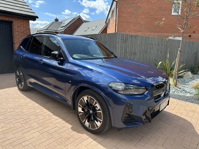

Here's a breakdown of what I had done:
Full Enhancement package plus Titan coatings
Full decontamination wash and wheels removed cleaned and arches flushed out
Multistage machine polish
Titan Dark matter PX10 base and TX145 Hydro top coat
Titan multi to all exterior gloss trim Infinity wax plastic coat to arch liners
Nanolex reactivating glass to all glass
Full interior hoover and protection to leather interior
Wheels coating inside and out with Titan pyro prx
The machine polish and clean to a full day.
I have no PPF on the car. It's a 2 coat ceramic comprising a base coat then top. I have a 6 year warranty on it but who knows what real world life expectancy is
At risk of a riot on a Jaguar site, here's the final result:
For the amount of work involved, I'd say that was an absolute bargain..

The sill cover sections, side skirts & front lower wings were £120.00 plus a rubber squeegee.
Only did the newly painted/polished sections. These areas are most vulnerable to road rash. Very pleased with results to say done outside on a windy day! You cannot tell PPF on there without very close scrutiny & I trimmed the edges, 5mm from edges, as opposed to tucking them around panel edges.
Time will tell how it performs. Just happy to protect the new paintwork. Can always be redone down the line.
Would definitely recommend having a go.
