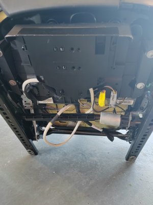

i have a drivers seat for sale £100, IMG_20230822_175629.jpgcollect from devon, full electrics and new metal work, have just changed out the leather

Sadly they are not the same seats as i have as otherwise i would have taken you up on that.
