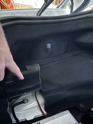

This was one of the first things I did and like you thought how on earth do I get the cable down. But by lifting the flap as shown in this picture you can pull trim just enough to get some fingers under to grab the cables. Tight - yes, but possible.

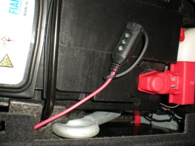

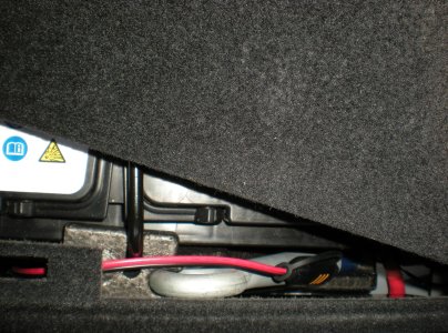

On my own car, I installed the CTEK Comfort Indicator which sits neatly below the battery access trim panel. It’s out of sight and easy to get at when needed (I’ve attached a few of my pics)....

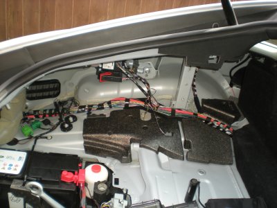

A nod to anyone else fitting in this position. There are other electrical cables and bits behind this panel so mind how you go with you drill / knife! I damaged nothing, but that was luck as much as intent.
The attached photo shows what’s behind the near side interior boot trim panel on my Coupe.
See this topic....‘Boot panel removal - help please’ https://www.ftypeforums.co.uk/viewtopic.php?f=27&t=4945
