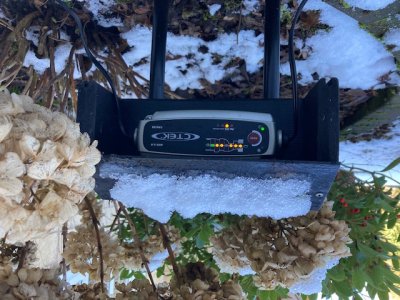

Charge mine with a CTEK in the driveway with boot closed and locked. No issues at all.
If your pic (first one below) was taken when charging your F-Type battery the CTEK charger is on the incorrect setting. Only the car symbol is illuminated whereas the car and AGM symbols should both be illuminated.

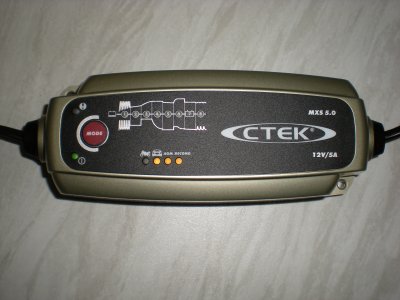

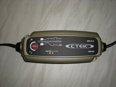

Once per year I also use the ‘Recond’ setting where the car, AGM and Recond symbols are all illuminated as per the CTEK MXS 5.0 instructions which include....“Recond your battery once per year and after deep discharge to maximise lifetime and capacity.”
The attached pics (second and third below) were taken purely to show the correct settings for charging my F-Type battery and the CTEK charger wasn’t connected to the car at the time.
