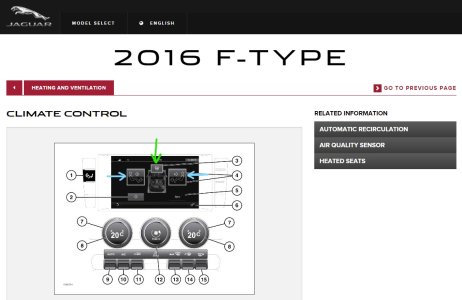

I think I know why the centre vent got stuck halfway open the other day? In your post you said.......“with the climate system already switched on in "auto", select "climate" from home screen and then select "upper"vents and centre vent will rise and blow air at whatever temp you have set (hot or cold).”
As I’ve always kept the Climate system in Auto mode and haven’t played around with the Climate settings, I took “upper” vents to be the top (upper vent) symbol on the Climate screen which is what I selected (see green arrow on attached image).
I’ve since tried selecting the ‘face’ and ‘face/foot’ modes (blue arrows on attached image) and the centre vent opens automatically as it should do. I’ll be using these modes more often in the cold weather as it’s nice to feel the airflow and heat coming from them :D

As I mentioned earlier, I’ve never had any issues with the centre vent coming up half way until I recently tried to open the vent by selecting the option from the Climate screen (shown in the diagram I posted) and also by lowering the cabin temperature. I have the centre vent setting in 'Auto' and it has always opened and closed correctly so perhaps I should have waited for it to open (as it always does on almost every journey throughout the year including winter time) before selecting the various Climate settings i.e. face mode, face/foot mode and windscreen mode?
Since I’ve had the car, I've only used the rotary dials on the centre console to adjust cabin temperature, blower speed and heated seats. I haven't used the various Climate settings (stated above). This is why I wasn’t getting the full benefit from the centre vents etc.
I’ve been out in the car today (got the MOT done) and the Climate system has been working fine as always with a very smooth and silent operation of the centre vent (opening and closing). I tried the three different Climate modes i.e. face mode, face/foot mode, windscreen mode and I’ve had a good blasting of heated air especially from the centre vents and foot well......this is more than can be obtained from only using the rotary dials on the centre console. In fact, it would have been too much to use continuously but it’s definitely a quick way for me to warm up if need be!
Anyway, all is ok......just wasn’t used to seeing the centre vent come up half way and staying there. If it ever happens again I’ll do the same thing that I did the other day which is.......switch off ignition, get out of car and lock it, wait a few minutes then unlock the car and open the door, centre vent should close immediately by itself as it has done with me on the two occasions which only happened recently.
