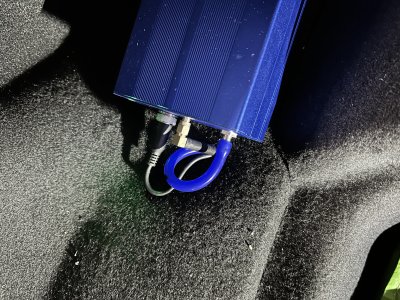

I have now fitted a valved cat back system which has a remote control for the valves so I control the noise level, not the ecu. It occurs to me that you could just install the remote control vacuum pump with the OEM exhaust and it would then stop the ecu over-riding the active exhaust switch position. The remote vacuum pump was supplied by Viezu. Been on for a while now and no issues.

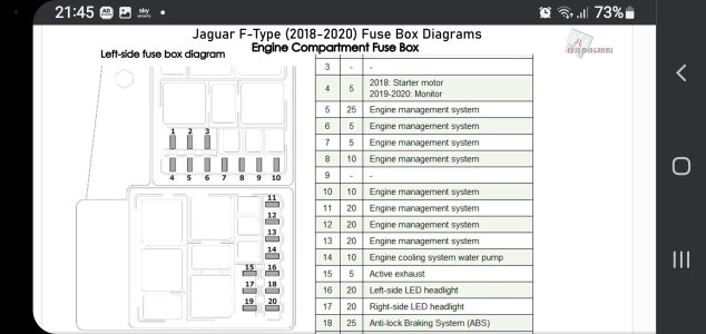

On this later car pulling fuse 15 in the engine bay fuse box left the valves permanently open as Mickjaguar describes earlier in this thread. (I can only assume the electronic control is disabled by doing this leaving the valves open by default.)Screenshot_20230227_214555_Chrome.jpg

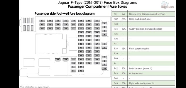

Earlier cars 2017have the active exhaust as fuse 43 in the passenger footwell fuse box.
