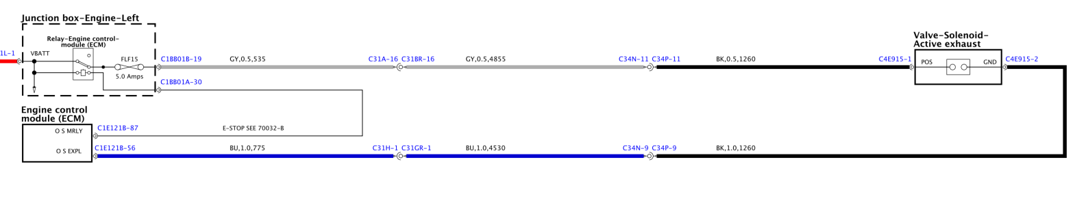

Most newer cars removing Fuse 15 will do nothing.
Why? - Because later cars (circa Plate 2015 MY 2016) do not have the vacuum pump, plumbing and associated valves that earlier cars have. They rely on manifold vacuum only to achieve the same result.
On early cars though, it is definitely F15 that is the one to pull:
For the full picture of the exhaust setup, of which the final page is handy, see attached.
