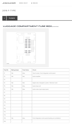

It could be worth checking fuse number F15 15A Blue - 'Front integrated control panel (heating and ventilation)' as shown in the attached screenshot which is taken from https://www.ownerinfo.jaguar.com/

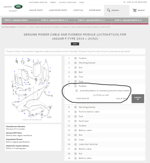

The Jaguar part number for the Quiescent relay fusebox (up to VIN K47319) is C2D23644, shown as item number 7 here.... https://parts.jaguarlandroverclassic.com/parts/index/part/id/152.1070.2402.11238/brand/jaguar/

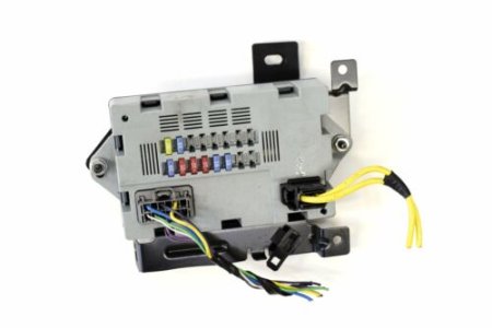

My fault code: "B1412-96 Quiescent relay box" is that the same like "Quiescent Current Control Module (QCCM)" ?
//Magnus
Worth checking Fuse number F15 as shown in my previous screenshot.
Yes, the 'QCCM' and 'Quiescent relay fusebox’ are the same thing as shown in the links I provided earlier.
