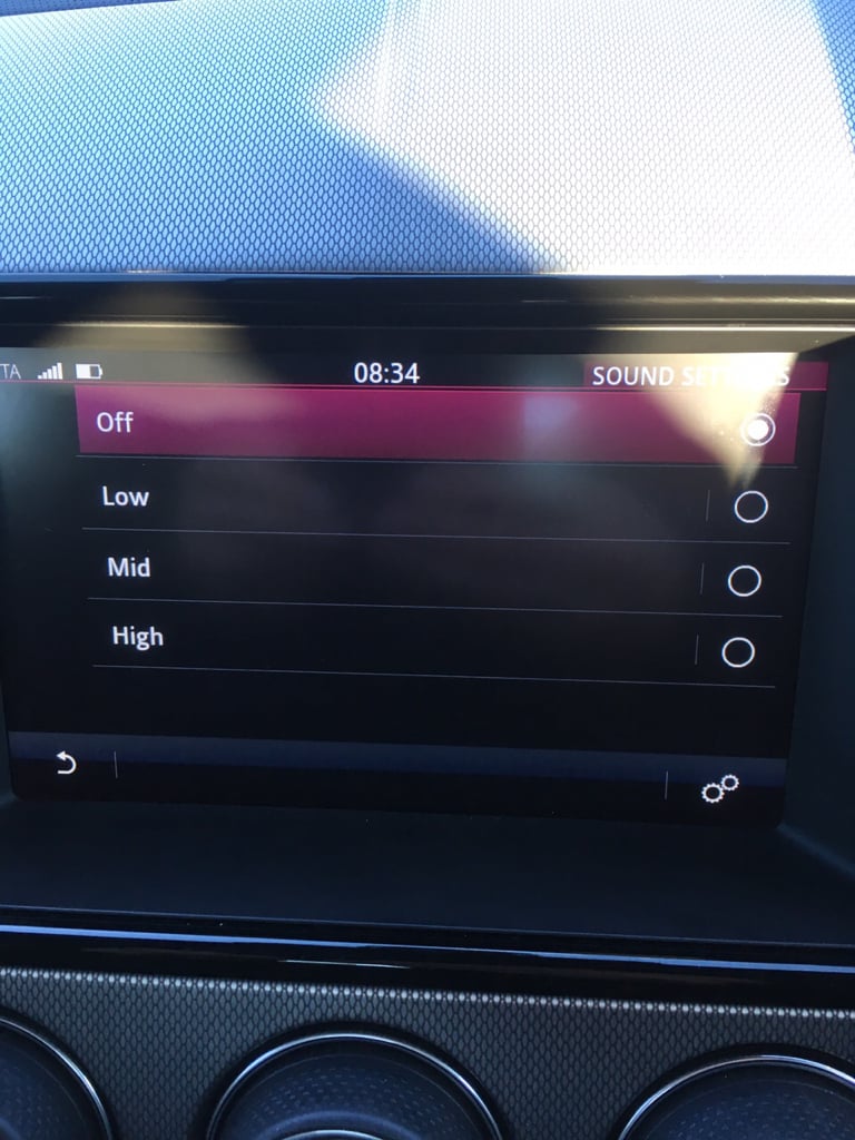

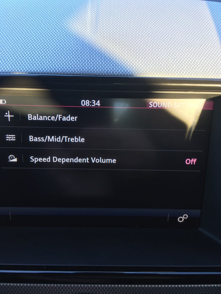

Speed dependent volume. It’s on my 2016MY -
