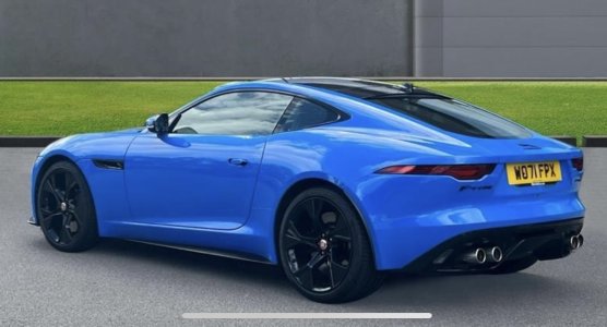

Wanted to post on here as a bit confused! For background I used to have a MY16 FType convertible V6S which I had for two years and loved. After the warranty was up I sold it and bought a TTRS which on paper you could argue is a better car and has been great but to be honest lacks the soul of the F-Type.
Anyway - 2 years down the line and I was planning to come back and have just came back from a test drive of a P450 Reims edition.
Now don’t get me wrong, it’s a beautiful car to look at, but where has the noise gone? I was expecting it to be a loud V8 (in my head it was going to be like a mustang or C63 or something) but to be honest it was pretty disappointing. It was probably a bit quieter than the RS (which is MY19 and also has the particle filter etc). When it got going it did make a nice noise but in general day to day driving it was so different to the old ftype.
I guess my question is when did they change. Was is to do with the particle filter or was it when the new shape came in.
Overall I am pretty gutted as I was so excited to come back to a Jag and own my first V8 but it just seems so much tamer than the old V6.
Am I missing something or is it just how things are now?
Thanks for your help!
