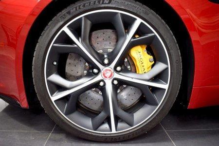

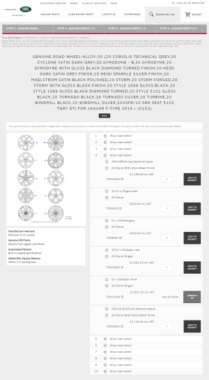

Not sure about aftermarket but one of the 20 inch OEM wheels that’s suitable is the ‘Storm’ (Front: 9J x 20 / Rear: 10.5J x 20).
Shown as item number 4 here... https://parts.jaguarlandroverclassic.com/parts/index/part/id/152.1068.2394.11207/brand/jaguar/
Are they the wheels that are currently on your car?
With the 'Storm' wheels, be careful when parking close to a kerb etc. Reason being that they are designed to accommodate the carbon-ceramic brake assembly and the wheel spokes are slightly more vulnerable to kerb damage i.e the spokes protrude further outwards. See examples here... https://www.ftypeforums.co.uk/viewtopic.php?p=61113#p61113

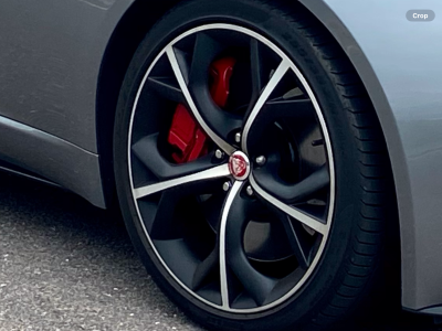

Also have a read through this https://www.ftypeforums.co.uk/viewtopic.php?t=3687 as it includes a screenshot showing some OEM wheels which are suitable for cars with the carbon-ceramic braking system including the 19 inch 7 Split-Spoke 'Style 7013' alloy wheel. I didn't think 19 inch would have fitted but it must be more to do with the spoke design as mentioned earlier.

Spoke clearance against the calipers is the difficulty. The only other OEM wheels that fit with CC brakes are the Maelstrom.
These barely have a couple of millimetres clearance between the spokes and front CC brake calipers. As a comparison with ordinary fitments, I've just measured the spoke to caliper gap on my Maelstroms with non-CC calipers , which is huge at 25mm.
