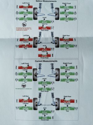

Had mine done today with a Hunter machine. Felt the difference straight away.
Just out of curiosity what did they find outside of spec., which they corrected?
White mans magic (if I'm allowed to say that)
Nice one. I didn't get such a detailed report but the camber on my left rear wheel was off by 3 degrees. Everything else was about 1 to 2 degrees out of specification.
