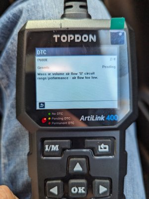

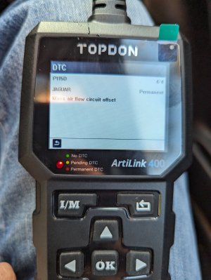

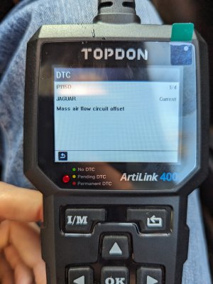

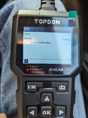

Unfortunately got a check engine light recently and down on power. No limp mode, just not nearly as quick as it should be, and not blipping the throttle on downshifts etc.
Read the codes and have the following, showing something up with one of the MAFs. I'm checking the battery etc to make sure it isn't that, but presuming it isn't that, any ideas on what you'd replace? I'll check the wiring / connectors etc but if I was replacing MAF, which one would it be for circuit B?
Link (search for p115d)

You can look the code up on that TOPDON 400 i.e. the P115 & PUOBE code, but I guess you knew that. I would have gone straight for the air filters.

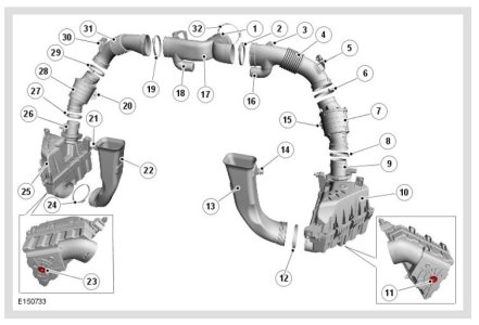

The air intakes are behind the front grill, pointing upwards, I supposed if you aimed a hose pipe or prossure washer into the front grill at the correct angle you could potentially fill the airboxes with water, accoring the service manual there is a drain valve on the bottom on the air boxes, in red on the diagram.
Each air cleaner incorporates a drain valve to prevent the
accumulation of water within the air cleaner housing.
