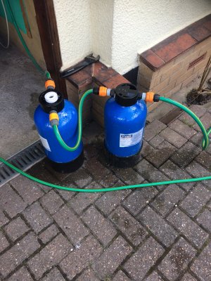

use a di vessel .. in fact, I have 2 one feeding the other

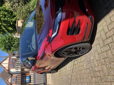

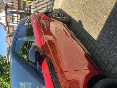

Just the other day rinsed our P300 HST with harvested rain water

I use water cans from our 3 water butts .. never have used a leather since ... also yes our drive needs weeding a job for this week
And you matched them to the colour of your car 😉
