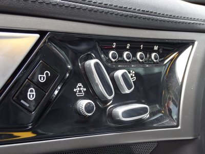

@Senninha
The side bolsters work like : turn the button to inflate or deflate..
The lumbar support works 4-ways. Push the button under memory 3 up and the support goes up, down and it goes down.
To inflate push it forward and backward to deflate..
thanks for the reply. mine are described on the build sheet as 14 way, and the control you highlight only seems to affect the side bolsters to the backrest not the seat squab. Its the squab that the problem.
Howard,
I read your original comment again, and I missed the clue it seems. The little button in the front of the recline switch
and above the seat switch, that can be pushed forward/backward to inflate/deflate. It can also be pushed up/down.
Now for me the "up" doesn't really get to the level where I need support..
