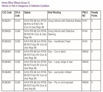

It is the same in Australia, the tyre pressures are the recommendations but should you have low or high pressures and have an accident this can be taken into account and used against you.

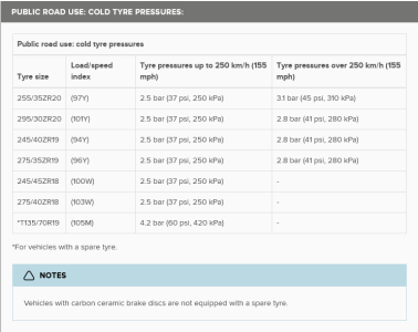

My car was originaly supplied with 18” wheels, but the first owner or perhaps Jaguar Engineering changed them to 20” wheels. They did not change the tyre pressure decal that is in the door jamb though.
The decal only shows the smaller tyre sizes. So to comply with a future IVA inspection, I ordered a new decal using the VIN of a similar spec car that came with 20”. Unfortunately I have been waiting over two months for the decal, and now I’ve been told it could take another 6 weeks due to software corruption.
So does anyone have a photo of the tyre pressure decal for 20” tyres on a V6 rwd convertible that they could share?
The onboard TPMS is displaying the pressures that they should be 37psi, but that could be wrong if the 20” are different and the software needs updating with the new wheel sizes.
Why Jaguar are so pedantic about producing a decal to VIN order I do not know.
Well thank you everyone for your confirmation. I won’t have to worry that the car is asking for the wrong pressure as 37psi is correct.
I’m really box ticking with the replacement decal for the IVA inspection. I don’t want to go down the rabbit hole of non standard wheel size questions because the 20” is not listed.
