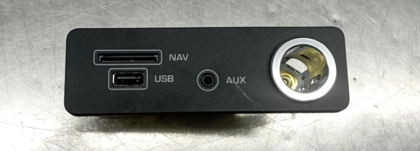

I have some issues with this module on my 2015 V6. here are the symptoms :
- The 12V plug doesn't work anymore
- The main display tells me "SD Card Not Found" about 70% of the time. But the SatNav works fine during the other 30%. I tried to insert/re-insert the SDCard but it doesn't change anything.
- The USB plug works well (iPod mode and charging).
- I haven't tried the Aux.
I'm really scratching my head to find where this could come from ? A simple fuse ? Do I have to change the whole module ? What's the part number ?
Help please :D
Have a nice day :)
Here is a picture of the module found on the internet ("I've been on the internet and I found THIS"... as they used to say on TopGear)
In the ‘Fuses’ section on https://www.ownerinfo.jaguar.com/ the passenger side foot-well fuse box shows....
Fuse number: F53
Rating (amps): 20A
Fuse colour: Yellow
Circuit: Accessory socket/cigar lighter (cubby box)
The part numbers for the interface etc can be found here....https://parts.jaguarlandroverclassic.com/parts/index/part/id/152.1082.2484.11586/brand/jaguar/
Fuse number: F53
Rating (amps): 20A
Fuse colour: Yellow
Thanks a lot RPSN. I'll test the fuse and keep you informed :)
Fuse F53 was the issue. 12V works great now. Haven't had the time to check for the Satnav though.
Thanks for your help !
