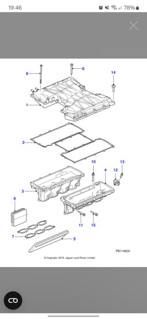

It's item number 5 and the part number is C2Z21669
Cheers, you did well to find it!
@T50 YOX...Tony, these are the part numbers, the description and prices:
C2Z21669, Insulator - Sound (outer), £43.42 inc VAT.
C2Z21670, Insulator - Sound (inner), £40.31 inc VAT.
They are shown as item numbers 5 and 6 in the screenshot that Panther provided and this is the link...
https://parts.jaguarlandroverclassic.com/parts/index/part/id/152.1063.2355.11046/brand/jaguar/
