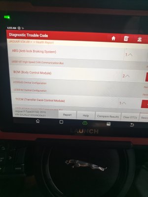

Evening all,
Recently my steering rack failed, without any checks I sourced a second hand one with same part numbers etc. Had it fitted but since then I have communication and component issues with my car. Can't connect to abs and no connection with steering rack. My mate suggested that sourced second hand steering rack will probably have component protection lock on it thats why nothing really works. Is that the case?
Code I am getting for ABS is U0001-87
And also for BCM - U2300-62
Any help or suggestion appreciated
