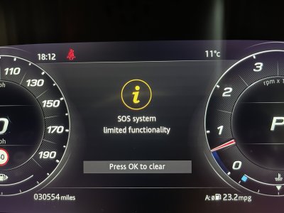

Hi all
Just wondered if anyone knows how to remedy this issue, as per photo. This comes up persistently while driving despite pressing OK to clear the warning.
I know what the SOS functionality is for, but what do I need to do to permanently clear the warning? As far as I know everything is working as it should.

Several posts on here for that.
A quick scan suggest recharge main battery or replace tcu battery (I think - check those posts) or replace the module.
https://www.ftypeforums.co.uk/viewtopic.php?t=4453
As above but I had this and it was an aerial issue. Change the TCU battery first cheap fix £25 diy job 2 min job. See if this clears the fault. I done this and thought it sorted it but sos came back on after a week or so.
After changing the TCU battery reset the sos button above your head in the centre hold down the blue lit button until it starts flashing that’s reset.
Given the age it shouldn't be the TCU battery. Mine also threw that error message a couple of days in a row the other year, and then it just went away. I'd say the first thing to do is to make sure that the main battery is well charged.

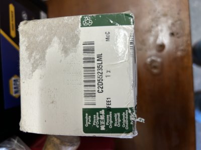

Managed to buy a genuine Jaguar C2D55235 DX2319C089 for £83.

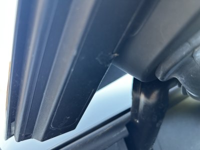

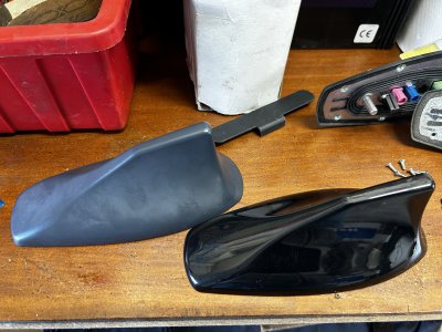

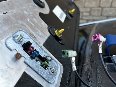

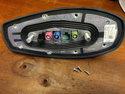

So today i decided to sort the antenna out...here are a few pictures of the process, a simple process that anyone of us could do.,,IMG_3489.JPG
If you are looking for a replacement that includes Navigation make sure you buy the correct antenna with 3 connections..(pink, Blue & Green)

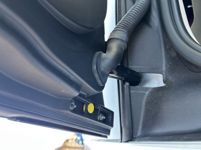

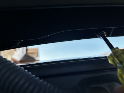

Lift the tail gate and at the very top there is a small removable flap that pops out to reveal 2 x 10mm nuts, same on both sides, IMG_3491.JPGIMG_3493.JPG
There are a further 2 x 10mm nuts on the underside leading edge of the tailgate

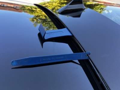

Using trim tools..pry the panel up gently until 4 yellow press fittings releaseIMG_3496.JPGIMG_3498.JPG
You can now lift the panel onto its edge and release the 3 coloured fittings...
These have a small white slide on the side...pull the slide up till it clicks then press in to release itIMG_3500.JPG

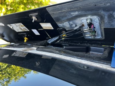

Then undo the 2 x 10mm nuts holding the fin to the base plate. There is also a push on ground connector to be released.
The antenna comes in grey primer but its easy to swap it over with your existing one using the 8 x T9 screws on the fin baseplate.

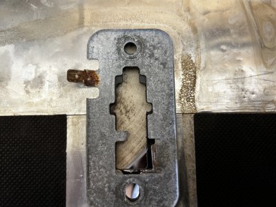

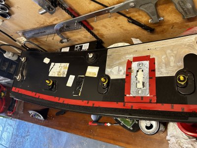

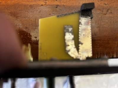

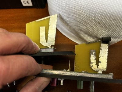

My circuit boards were quite badly corroded and the Ground connecter was badly rustedIMG_3504.JPGIMG_3501.JPGIMG_3505.JPG
I cleaned all the rust of the grounds, used some 3M 3mm number plate tape to try and stop water ingress or at least reduce it,,,,
Refit is a direct reverse...
My Limited SoS function warning has cleared and my sat nav has returned to base...
All in it was maybe a 60 - 95 minute job
There was some really gooey sticky sealant there...but the excess was easily cleaned off with WD40
All in it cost me £85 ,....
