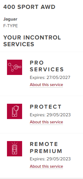

Have any of your licences expired?
I've had issues on the Evoque since it crossed 5 years old. From memory there are about 4/5 JLR and third-party licences needed covering several different aspects.
Good idea, but all OK.
(And journeys are still being recorded and remote app still working).

Looks like they are all OK. There are another 1 or 2 licences, but iirc they relate to the actual maps, so would not impact it
