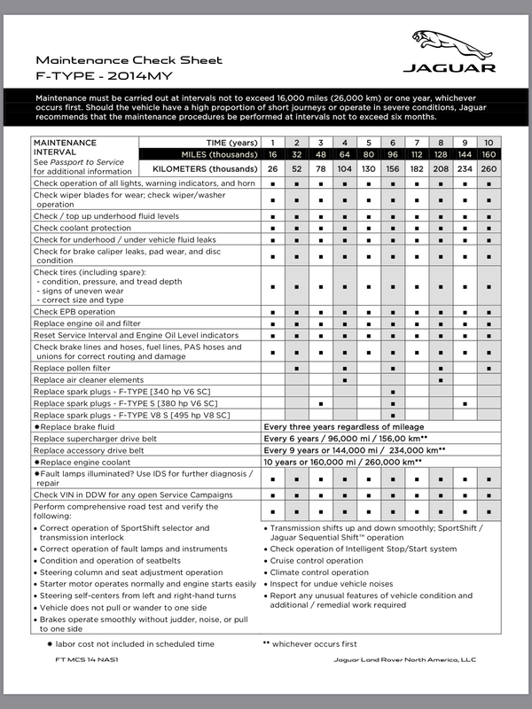

I have been trying to find the service schedule for the V8s . Mine is a 2014 and I'm trying to find out what the service requires this year. But can't seem to find details anywhere. Can anyone help. Cheers.

I would double check with your preferred dealer/specialist. Your car (VIN ending *****577) had it's last service recorded on 20-JUN-18 with 13,888 miles as 4yr service
Service Completed
64000 miles / 48 months service
Other Related Items
Renewal of Oil and Oil Filter
Renewal of Pollen Filter
Renewal of Engine Air Filter
Renewal of Rear Differential Fluid
So this years 5yr service should just be the cheaper interim service however it should of had a brake fluid change at 36 month/3yr service but that is not recorded because the 3rd service is missing from the online system. Of course you might have paperwork for the 3rd service that says otherwise or if you dont check with your dealer.
HTH

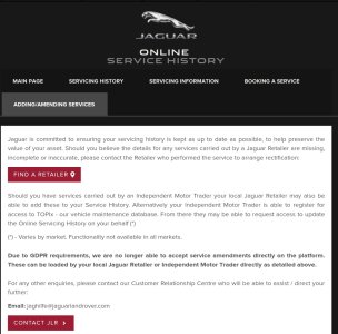

Thanks so much for that guys.Yes I have all the invoices relating to the services including the 3yr service which as you say is missing from the online history. Do you know if this can be added to the online system or is it too late now.
Cheers Neil.
Yes it can be added by the service department. You might want to get the missing 1st Service added and the incorrect mileage on the 2nd service sorted as well!
With the service history all online I find it reassuring to find a perfect JFSH online at time of sale.
Thanks . All the services were done by the previous owner at a dealer in Ascot and although I have all the invoices it does not show on the online system correctly.
Have to say that's another lazy dealer thing that really annoys me.
Such a simple thing to do right at the time of invoicing.
Had to chase mine up 3 times before they eventually added it about 9 months later.
Well no joy yet. I rang the supplying dealer to try and get the 1st service added online which they did and I have the invoice, only to be told it's too late to be added now. Then I rang the second dealer who put the mileages on service 1 and 2 the same on the online system , once again I have both invoices with the correct milages on and service details. But they say they don't think it can be changed now . When people pay this amount of money for a service I would expect them to get it right first time.
That's just lazy of them!!!
Give them another chance and ask them to double check.
There's really no point in having an online service record if you can't keep it up to date.
