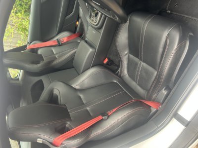

Hello Steve. I had my seats replaced a couple of years ago. My original base seats had the basic movements but were heated. You should aim to purchase your new performance seats with the same functionality for a trouble-free swop.
These came out of a 2015 V6S…
My trusted Jag Indie carried out the work for me. He retained the seat modules as they are VIN sensitive. This ensures all functionality is passed across with no additional coding.
Seats were approx £800.00 & garage charged £180.00.
They are in VGC but a future project is to have them reupholstered with a headrest logo.
Good Luck with it 👍
Couple more points…
Not sure I explained it clearly but important to swop the original seat modules into the performance seats. Seats are VIN sensitive. Now my car thinks the performance seats are the originals.
The original seats are practically worthless. I stuck mine on eBay for £150.00. Mo from LR Retrofits bought them for £90.00 for a project.
I’ve a contact in Nottingham who seems to get hold of F-Type parts. I don’t know him personally but he got me my performance seats. Another owner off here had some bits from him recently. Send me a message & I’ll give you his number 👍
