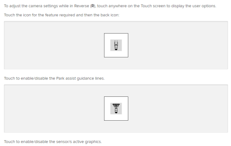

The rear camera settings can be adjusted.
Worth trying.....
