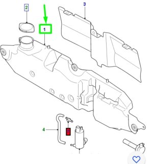

Part 7 in this diagram
I don't think you can but parts 4 and 7 separately.
Try T2R7586. Looks around £3.25 and looks like part 4 and 7 moulded together. Could just be clogged up.
That might be it then. I was hoping to change it without pulling the bumper but I obviously can't with that part. There's also that part in the bottom right side labelled as "valve" so it could also be that. I might flush the system first and see what happens.
