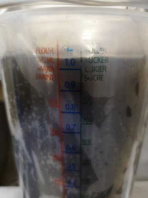

Car on its wheels, removed first the refill plug (8mm hex), and some oil started dripping slowly but surely.
Rushed to open the bottom plug and got all the oil out, black but no sludge and just a little fine metal powder layer on the plug magnet.
But the surprise is that I got a bit more that one good litre of oil out :shock:
With what's on the floor, almost 1.1 litre.
Now in doubt whether I refill with the recommended wet fill of 0.815-0.830 litre, or try to push in 1.1 litre?

Well obviously as this is the first diff oil change, it was originally filled at factory with 1.2L which is the V8 dose 🙄.
Have now filled with 0.84L and called it over.
