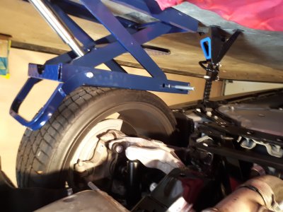

You can use a set of hydraulic ramps from CJ Autos, they lift the car to 500mm allowing you to put the axle stand on the jacking point. The ramps can be controlled independently which means you can do one corner at a time. Picture is of my car on ramps. Apologises pic up side down. Phil.
