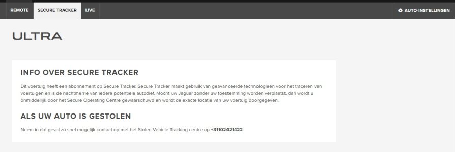

It seems not to be available in the Netherlands. In only confirms there is a tracker active and a subscription.
"Dit voertuig heeft een abonnement.." = This vehicle has a subscription..

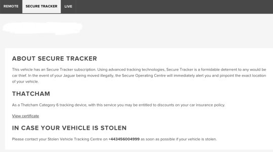

Hi Dan,
Logging in through UK site gives me this screen. When you click the “view certificate “ link you get all the references and certificates. Maybe the Dutch JLR importer could help you?
