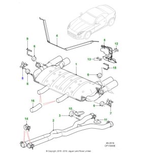

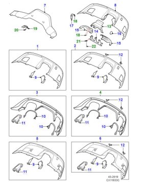

Hi guys I'm thinking of changing my v6s twin exhaust to a v8 quad exhaust. Has this been done before and will I need to replace the full rear bumper or just the rear diffuser. I was hoping to replace the back box only. Thanks in advance for any help and advice.
John.
yes its possible, just a rear diffuser change (bumper is ok)
would think you need to change some of the brackets and mounting points underneath though
Thanks for reply guys I can get hold of the quad rear box so will have to look into prices for rear diffuser/valance and mounting brackets.
I looked and actually had a back box to hand. Decided against in the end for a few reasons
It had to be a full bumper change as not able to split to older V6 bumper
Adapters were needed as v8 exhaust had a different bore
Minor on location brackets and active exhaust points
Concern about the gas volume and eventual sound. Ie pushing 3l volumes through a 5l engine designed system
All easily overcome but I opted to create my own custom rear for the V6 twin pipes
