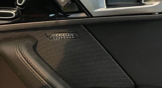

• Mark levinson premium sound system - MERIDIAN SURROUND recommended

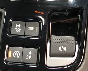

And now to my second question, how do I spot all these options from pictures? Some example pictures would be most welcome so I (and perhaps someone else) could learn.

High end audio

How do I tell apart the LED headlights from HID ones from the pictures? Would anyone be so kind and upload the picture of LED headlights?
Also, which seats are more comfortable? I'm quite a tall lad so lower back hurts on longer journeys if seats are not good.
And heated and cooled seats have a word "push" displayed on the button at all times?
