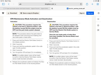

Looking at the downloaded instructions…..it clearly says to have ignition off and either in “park” or “neutral”….so it would make sense for the transmission to be in “neutral” if I want free wheeling rear wheels to perform any maintenance!
see pic of the JLR instructions
I just tried and cannot seem to ove the vehicle into neutral when ignition is OFF
Have I missed something?
