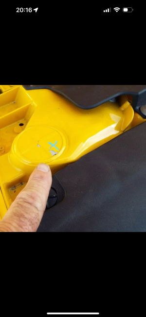

I’m looking at a cat S which is about £10k less than a clean example but no damage other than the front strut tower cap shows sign of contact with the wish bone.
My question is in there no bump stops, I am aware at the potential issues with it being AWD and going beyond it’s intended range of motion. Trying to figure if it’s worth the drive to go and see it as it’s quite a drive.

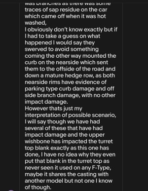

Sure they are a breakers / salvage company, so usual salvage kind of guy, I asked for photos of the suspension top mount but he says he can’t get a good pic. It’s also minus a win mirror
Did a check on the car and it’s all serviced and a cat S. he says there isn’t any damage to the under side of the car but some light branch damage. It’s a shame as it’s a nice looking car and would be a decent upgrade to my 2018 p300. I have a endoscope so might just have to go and have a look. Just wanted to get an idea of what was the likely component to make the impact, I am guessing under that piece is the suspension strut so most likely it would have popped on blown that.
Here is his response
